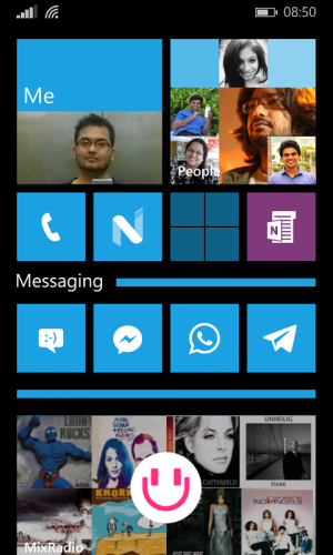

The update downloaded and installed fine. I got both the updates and now running Windows Phone 8.1, Update 1. wp_ss_20140807_0003.png
