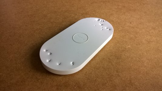

My roommate's dog had gotten ahold of my wireless charger and decided it was her chew-toy for the day. Fortunately, it was still functional! However, the aesthetic appeal was all but lost. Determined to still get some use out of it and to keep it out of the dog's mouth, I decided to implant it into one of my old IKEA Lack Tables with the intention of simply being able to put the phone down and have it charge.

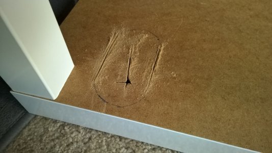

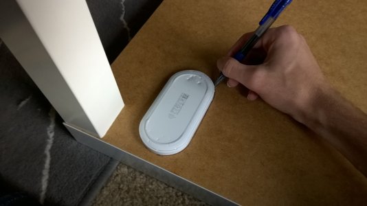

Step 1: Trace where you will have to cut. Using the charging pad as a reference, make your outline extend ever so slightly past the actual plastic case.

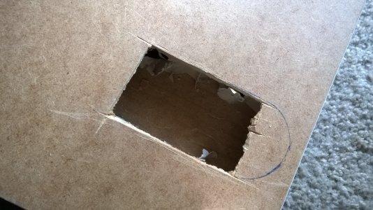

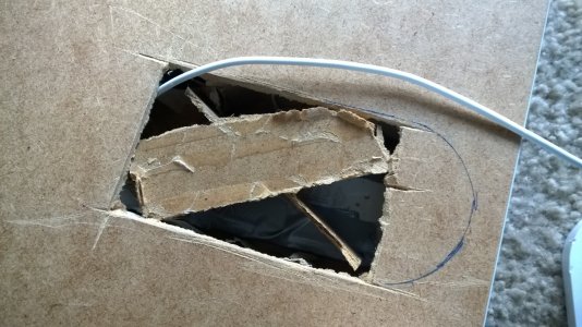

Step 2: Cutting time! Be careful picking what you want to use to cut into the underside of the table. Since there's only a thin layer of cardboard filler beneath the surface, I could easily see something too sharp puncturing the other side. (Personally, I used a butter-knife. The serrated edges acted like a saw and it was small enough that it was easy to control!)

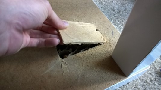

Step 3: Remove the cut surface.

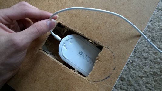

Step 4: Remove the cardboard filler to make room for the charger.
Step 5: It fits!

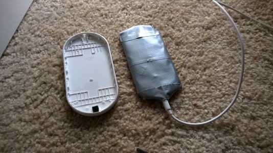

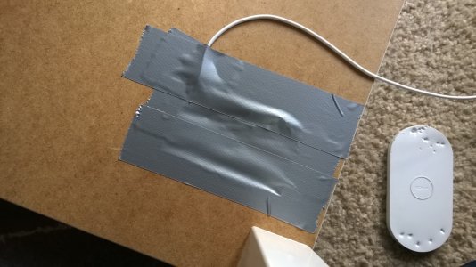

Step 6: This step is entirely up to you! However, I removed the charger's cover and taped over the top of the electronics with duct-tape. This allowed me to get the copper coils even closer to the surface of the table.

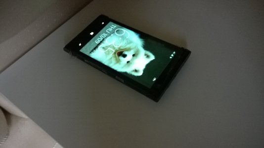

Step 9: It works! You may want to mark the table so you know exactly where to put your phone in the future.
