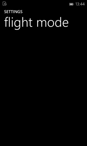

Not able to turn off flight mode ?
Hrishikesha
Nov 30, 2013
3

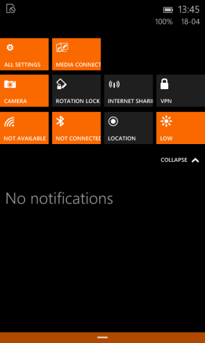

After I enable flight mode,i unable to turn off flight mode.Under settings -> network & wireless->flight mode...it is blank.
In notification also option of flight mode disappeared after flight mode was turned on.
