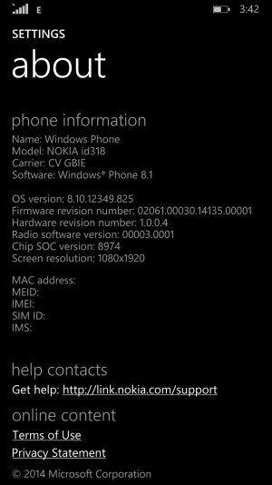

If you go to the about screen and look under carrier what does it say?
Also can you confirm what you see in the extras+info page under Manufacturer name?
I have feeling you most likely have a demo unit or perhaps a developer unit, however the more info you can provide would be helpful :).
Under carrier in the about screen it says CV GBIE.

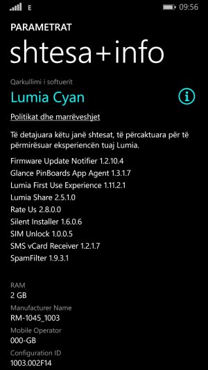

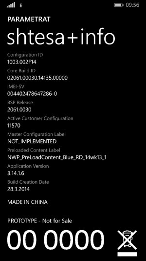

Sorry for the delay, below are the pictures of About and Extra & Info.
I had the phone in Albanian and that's why the Extra & Info is in Albanian. When I turned the phone in English the Extras&Info section doesn't open.
I've tried to update but it doesn't show any update even why all CV of Lumia 930 have already got the Denim update.
Anyway I don't know which can be the right firmware for the phone if its a demo/developer model, or if it can accept another firmware at all.

Yup, the "not for sale", "prototype" and preloaded software indicating it is a "Blue" build compiled on the 28th of March are huge red flags indicating it is a developer model. As the code name for 8.1 was blue and the compiled date coincides with the April build event. So I imagine it was a loaner device (the op indicated the seller was a marketing company who had done video for Nokia) that got "misplaced" :P.
I don't know if you could flash a rom using navifirm and Nokia care suite. Personally as it your phone appears to have hardware defects, I would also suggest contacting MS in regards to a replacement.
Hardware revision 1.0.0.4....
I believe that the oldest sold was 2.0.0.1, I don't even know if it's safe to reflash the above with the current stock ROM's and if the configuration is still supported.
