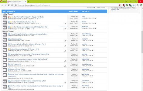

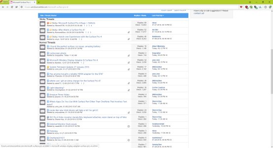

2. Text blurriness on traditional desktop apps when taken out of the dock.
The first screenshot was taken from my 1080p monitor. The second one was taken after I detached the tablet from the dock.
I noticed this problem in Firefox & Opera. Edge & the News app didn't have this issue. So, I am assuming modern Windows apps are free of this problem.

To add to the point 2 regarding text blurriness, looks like it is the norm. Only modern Windows apps and a few others like Edge doesn't have this issue. Outlook 2016, Word 2016, Visual Studio 2015, latest Opera, Firefox all of them show the problem. It exists in both scenarios - if I have the Window open before docking and then dock it, or if I have it open when docked and then undock it. Only way I know to fix this is to reboot/logout.
