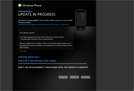

Maybe it was me sending LG an angry email letting them know that I've switched the a Nokia Lumia 920 because they support their customers better, or maybe it was Microsoft.

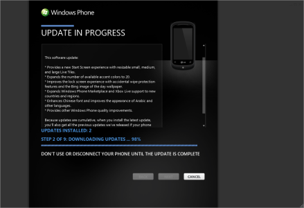

But, whatever it was. I downloaded Zune and plugged in my (fully reset (erased)) windows 7 LG Quantum (bought on first day of WinPho 7 release) and voila it started updating!!

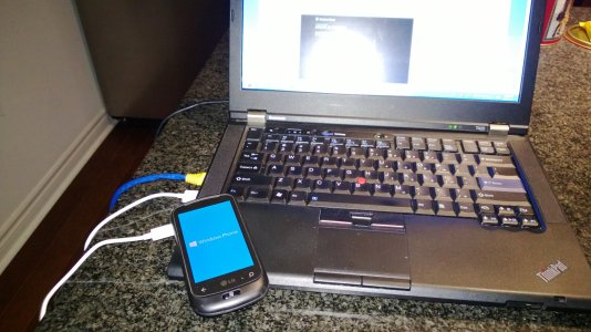

Didn't expect that! I'll carry it around along side my 920 tomorrow to see how it works!
DONE!

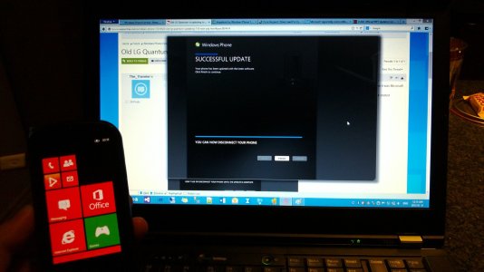

Now running 7.8 on an AT&T Quantum after SevenEighter ended up doing most of the work...and loving the updated UI, plus the Tango features I never got.
There is hope LG Quantum owners! Just completed the update on an ATT branded Quantum without having to flash a new ROM or use sever-eighter.

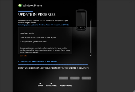

Trip report, I just used Seven-Eighter and it only got me to 8779 for some reason. I kept trying and it just kept doing 8779. So I then switched the brand from ATT-US to BELL-CA as above and Zune finished the job and took me all the way to 7.8. I then branded back to ATT-US. So far looks to be working great.
