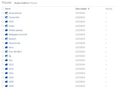

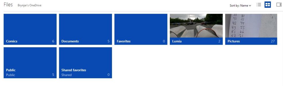

Thanks for your reply. As the attachments show, the "Pictures" folder is at the root level of OneDrive and contains "Camera Roll", "Mobile Uploads" and "Saved Pictures" along with all of my archived pictures (sorted in various folders). The problem is basically that all these folders within "Pictures" are not being synced properly to the Photo hub.

Notice the white squares on some of the folders? That designates the contents as pictures. Apparently, file type properties in OneDrive aren't automatically inherited by child folders. It may be a quirk when the folders are created on your C: then uploaded...
Check the box to the left of one of the years, then right click and choose properties. In the Details pane at the right, you can see folder type... and a change link. Specify folder type Pictures for any of the folders that don't have the little picture icon on them...
Thanks for the tip, but no luck. The ones that already had the "pictures" folder type weren't appearing in the "OneDrive Albums" folder in the Photo hub and changing all the others didn't seem to have any effect. Also, it'd be strange if that were the problem since it's working flawlessly on my Lumia 800. Another odd thing I noticed is that the "OneDrive Albums" thumbnail is a picture from the root of the "Pictures" folder but when I open the album it's still completely empty.
