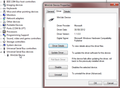

Damn this sucks. i got win 7 x64 didn't have a problem with my htc 8s
Have u tried to use the update driver from device manager?
i dunno what driver it uses. but this is the one from my manager if it helps:

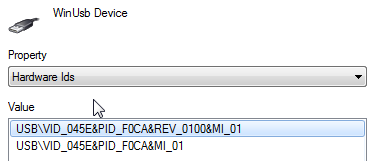

Also the driver id:
I dunno what to suggest other then what has already been suggested. But i thought u could get the driver from the support or something or find it somewhere.
Hope it helps
