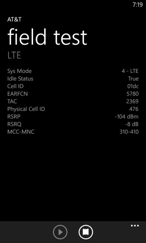

The first two screenshots are from when my phone was functioning normally:
This from a period where my phone is dormant and not responding:
This is immediately after when I sent a text message to re-establish connection:
Ok, that's helpful insofar as it rules out my theory that the radio is going to sleep because of a marginal signal and ENS being enabled. There's plenty of signal (in LTE terms). You are running on the merged Cingular/AT&T network.

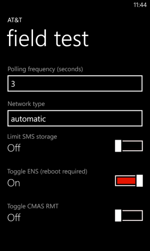

Ok this is a problem cuz I had mine set to 3g in order to save battery life and now I cant switch back to get LTE . . Please post if anyone finds a workaround . . I would like to have LTE back :(
Just an update: I've not had any connection problems since the update. It may have solved the issue.
Probably your only choice would be to flash a non-AT&T version of the ROM, use ##3282 to set LTE back on and then flash the AT&T version back again.
