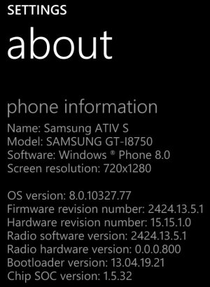

Hi all,
One week ago I bought an unlocked Ativ S, via Amazon DE (the seller was in UK). I live in Argentina.
Everything works OK, but the phone part.:shocked:
One or two times per day, the phone shows the "no signal" icon on the top left side (the signal bars with a "forbidden" sign). :angry:
However, if you manually reboot the phone, the signal comes back fine. This happened in different parts of the city, and I don?t see a pattern yet.
The problem is not that there is no signal in a place, but the fact that it doesn?t detect automatically detect where there is. This renders the phone unusable, as you can spend hours without signal without knowing. :cry:
Normally the phone is with wi-fi on, and no 3g, nfc, or bluetooth.
All GSM bands from Argentina seem to be supported by the phone.
I didn?t change any factory settings that seem related, and I don?t find any. The only settings that seem customized for Europe are related to mobile data.
I?ll attach an image of the OS version. Does someone have any idea?? :unhappysweat:
