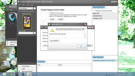

Hi. anyone know how to change the lumia rom 1020? Is that the Nokia Care Suite will not let me download the new rom and flash.
What exactly are you trying to change and to what? Aren't you already on the updated ROM.
This is my problema. I can?t download the firmware with the Nokia care suite
I'll reiterate my question. Why do you want to download it? Don't you already have the latest firmware on your phone.
