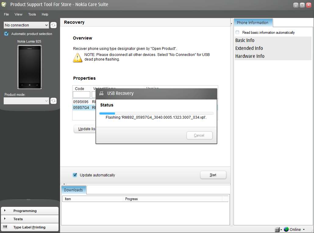

Tried several times, cant get it into flash mode. Power & Volume Down does a soft reset. Tried Volume and Power Down until it vibrates then Volume Up and get the Flash & Cog symbol (is THIS Flash Mode?).
In Product Support Tool. Recovery. It tries to verify package but I then get this error:-
DTL Connection: Could not connect to media. DTL Back-End error code = 0x8400A403. DTL Back-End: Driver initialization failed. DCM status code = 0x84007406, Common Connectivity DCM: Connection opening failed, Connectivity API status code = 0x84007419, Target media is active but it is not working.

Ok, what suggest you do is delete everything after the products folder, c:ProgramData/nokia/packages/products. Redownload one product using NCS then flash that product.
No, if you see the cog then its not in flash mode.
When NCS ask for you to press the buttons press
Volume down + camera + power wait till vibrate and release the power button after a few secs release the other too. But just before the vibrate, so as the screen turns off click retry on NCS.

Yeah try what Michael said - also, don't worry about that data package error in the bottom right corner, I got it to, it's normal but you can safely ignore it. Managed to flash mine even though it was there.
Also, as I said before, there is defo some sort of sensitivity in regards to the exact version of NCS you use. If all else fails after following what michael suggests, I would (I know this is a shag) uninstall NCS that is on your computer and then reinstall it using the link for the version I use. Also make sure you put that userconfig file into the folder I mentioned.

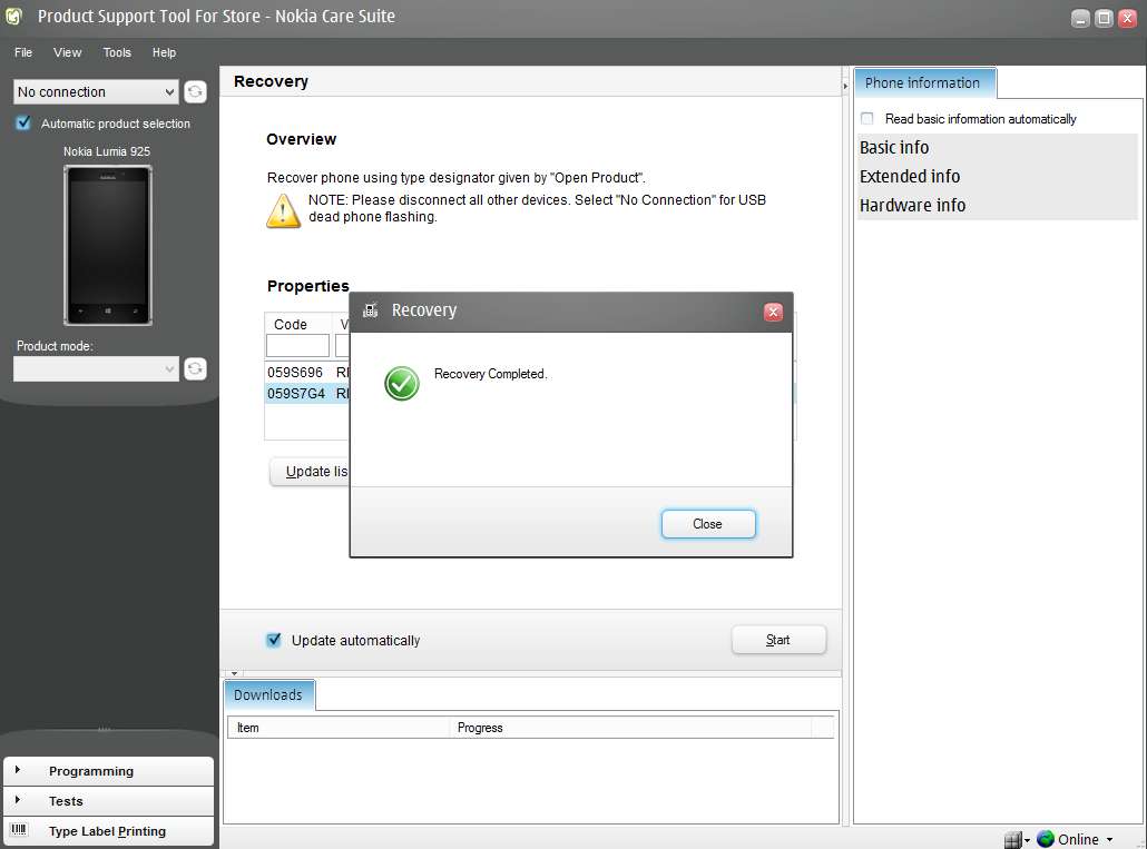

Guys.... Thanks for your help. All sorted .... Some how ;)
On the previous attempts I never got the NCS asking to press Volume/Power and restart... Just got errors. I tried a different USB port. Errors again and tried it for a final time then had the NCS request for Volume/Pwer etc. and then all flashed fine with EE unbranded. Happy days!!! Thanks again

It was probs due to you already having your phone connected. If you ever flash again. Go through the flash process without having your phone connected. NCS will then give you the retry option once you've clicked start.
