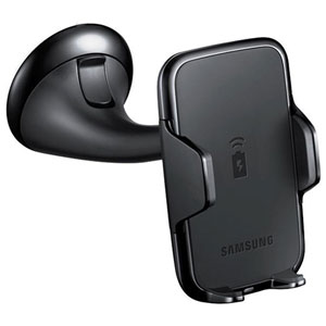

just to inform you I bought a Samsung wireless charger and a Samsung wireless car charger and they both work fantastic! I'm super happy with them!
