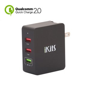

I use a different (Non-Qualcomm Certified) Version of this one with two 1 amp charge ports and two 2.4 amp ports. I have my 640 on the 1 amp because I'm not interested in quick charging. It's on there from when I get home in the evening until I leave then next day. It's well made and it seems that all of their chargers get 5 star reviews on Amazon. Has a one year warranty which is pretty much unheard of in electronics.
How do you know if one you're looking at is definitively Qualcomm Certified? The Tronsmart Titan I was mentioning doesn't say certified but it has the Qualcomm logo which I assume they can't just print unless Qualcomm approves, no?
Looks like a solid charger. I have found my 5 port charger to be invaluable. Easy to throw in a bag when we travel without having to take a lot of adapters and search for multiple available outlet plugs at the hotel. Simple. Easy. Love it. Mine is only 50W instead of 90W. You would be getting a much better one than what I have, but I don't have any tablets to charge, just 2 phones and a couple of Bluetooth devices, so 50W is more than enough for me (not to mention I got it for half the price of the 90W version.)
