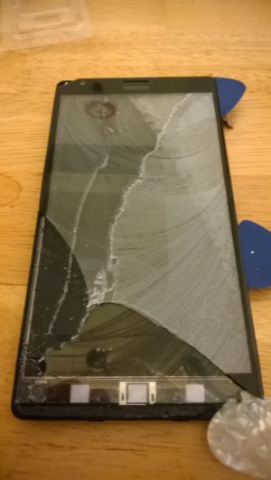

Like the title says, has anyone here replaced the glass screen/digitizer combo with out the LCD? Its a lot cheaper ($50-$60 versus $220+) and my lcd is fine.
I have disassembled many phones for repair so that part doesn't scare me, what worries me is no pictures/videos of anyone prying off the glass.

My understanding is that the LCD is bonded to the glass/digitizer so it will take quite a bit of work getting them separated.
Good luck if you do manage to get them apart. :)

Every store I've talked to has said it isn't possible.
I say it is, because a part of the digitizer in the bottom corner of my broken phone has already broken off.
But apparently, it's very easy to break the LCD by attempting to just take the glass off. Cheapest rates I've heard of were 200 at Palco Repair, and 240 from Nokia Care. Good Luck.

The video (of Lumia 820 replacement) is irrelevant - the process for sealing LCD to digitizer / glass has changed since that device dropped.
Pull the service manual for the Lumia 1520 (Google it, it's out there, I have it) - Nokia doesn't even recommend it. However, it'll break down what's what. It appears the full LCD / digitizer / screen assembly replacement is vey straightforward.
IF you want to DIY, that's what I'd recommend, though the complete assembly is ~~ $160 to $180 (not saving very much).
IF you manage to remove the glass screen / digitizer without damaging the LCD, the catch is putting them back together, the heat generated by the device subverts most adhesives - then you really have a problem ...
Good Luck, let us know how you do !

I bought a Nokia 1520 off eBay I'm gonna give it a shot ....the LCD is good but touch is out I hear the digitizer on eBay won't work Idk but I'll get it this week will let you know how it goes ..
MDK22
Oct 17, 2013
1,375
Be extremely careful around the PROX sensor, any little bit of dust / glue / detritus will screw the phone.
And, if you don't already know, you need a special heat-resistant adhesive to bond those together.
Good Luck, waiting to hear how you do.

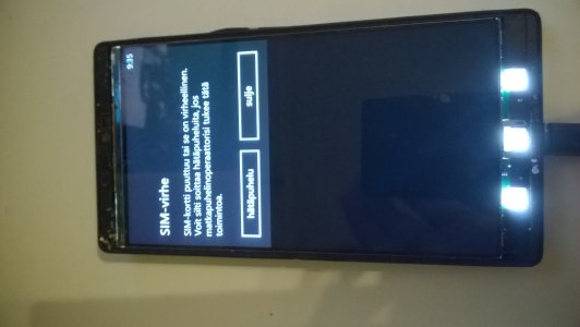

I got the glass of easy but how to apply digitizer I can't get it to work on my 1520...and I have a s3 touch works but home button and back don't work any idea
