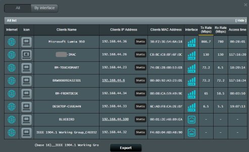

I did some more testing...the problem occurs with 802.11AC, 5Ghz N is fine.

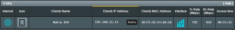

I'm watching it.... no disconnects yet. You might want to look into your wireless AP's settings? 5g AC is known to be... finicky.

Thank you for replying! Looking forward to hearing your results. I looked through the router's web utility, but the characteristics of the issue make it seem like a WM10 OS or phone hardware problem. Why else would I need to restart the phone to see other WiFi networks again? If it was a router only issue, you'd think the connection would drop and I could just select another connection in the phone's settings. Just thinking out loud here, but anyways, thanks for helping out let me know how it goes. Keeping my fingers crossed you don't have the same problem.
