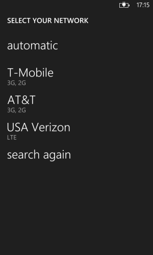

I have factory unlocked Lumia 928 (made for US Verizon only) and I'm using T-mobile's sim card in it. Both Verizon (V) and T-mobile (Tm) has LTE, but I dont have LTE which Tm offers. I went V's and Tm's stores and was told that only V's sim card will connect to LTE on my phone. So playing with my phone here's what I found a couple days ago
As you can see LTE is listed only under USA Verizon and under T-mobile only 2/3G
So Im guessing it's blocked
ps. if you want check it go to Settings-Cellular >> tap Network selection, it will check for networks, takes about 20-40 sec. See if it shows something for you
Re: Rogers 920 on T-mobile no LTE data connection
Well that's because the 928 doesn't have the LTE band support for T-Mobile. Thanks though.
