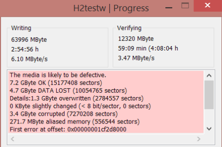

I would run H2testw or something similar on that 64GB card. What file system are you formatting with? exFAT or FAT32? I would also use a 3rd party formatter like guiformat or diskpart. There are a lot of QC issues with high capacity SDXCs could be a faulty card at the end of the day.

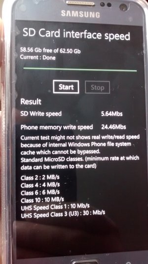

I just got SanDisk Ultra 64GB MicroSDXC Class 10, it is working fine, the phone accepted it fine, as 62.5GB.
The only problem is the writing speed, is very low compared with the 32gb CL10 I have, writes only 4.20 Mbps vs 16Mbps on 32Gb.

Speeds:
SanDisk Ultra 32gb UHS-1 = 5,10mbs
SanDisk Extreme 64gb UHS-1 = 9,58mbs
Samsung 32gb Class 6 = 9,10mbs
Samsung 32gb Class 10 = 5,80mbs
