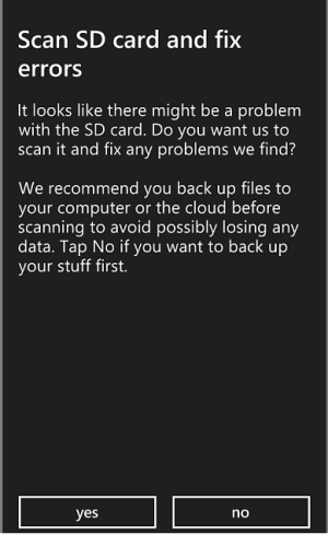

I started getting this error after about 2 months after updating to Windows Phone 8.1 Lumia Cyan. I never got this error before on Windows Phone 8.0 Lumia Black. When I insert the SD card with an adapter into my laptop with Windows 8.1 I also get an error.
Anyone using their phone with a SD memory card get this error? Did you only start getting the error after updating to Windows 8.1 Lumia Cyan?

Errors on SD happen and the longer you use them higher the possibility they occur. And also in black these errors happens so they are not 8.1 only.
You can use your phone or pc to scan on errors and try to repair them. Your pc is "better" in repairing them. If the error can not be repaired you can format the card (but you loose your data). If the errors are repaired or the card is formatted you can use it again in your phone. But if there are again errors after a while I would recommend to buy a new card.

I scanned my SD card with my phone and the error comes back after a while. I also scanned my SD card with my laptop and the error also returns back after a while. Nothing seems wrong with my phone, its just kind of annoying seeing the error and having to scan quit often. I always use the USB disconnect utility whenever I unplug my phone from the laptop

I formatted my SD card through the phone and the error returns. I also formatted the SD card with my laptop and the error also returns.

I had this problem after Denim too. On my Lumia525. It's the same SD I used with Black. It was a Class6 SanDisk 8GB. I thought the card was faulty, so I bought a new SD a Sandisk Class10 with 16GB. I reinstalled the apps (I don't use that many apps BTW). Recently I did a soft reset to my Lumia525 after some freezing after taking photos (I forgot on which camera app). the soft reset I'm referring to is the one where you hold the down key + power for 10 seconds. Once done, it shows SD card error like OP above. I turn off and back on, then another time removing the battery but that problem still persists until now. Now if I turn my phone off then every time it is back on, it gives that SD error message. I dunno how to solve it, backup my data...just in case.
I have this issue with my L1320.. Had to give up my 32gig SD because of that crap. Constant errors with SD card in the phone. I'm running cyan. Countless scans and repairs in phone and PC. Eventually I had no choice but to use an 8gig I had laying around. And I still get that issue every now and again. This L1320 is notoriously bitchy with SD cards.
I have this problem in my 630 Lumia WP8.1 update 1 PFD, but its only when I restart the phone.. When phone is switched on and after Windows logo appeared a message popped up and telling me to "Scan SD card for errors". I just ignore it as I don't restart or switch off my phone often.. Otherwise I don't get any error messages beside that.. Is it ok to ignore it or should I change my SD Card a ( 16 GB Kingston class 10 )
Check in above posts there you find what you can do.
No best is to scan it for errors on your phone or otherwise on your PC.
If the error's are "repaired" but they come back again than change your SD card.
