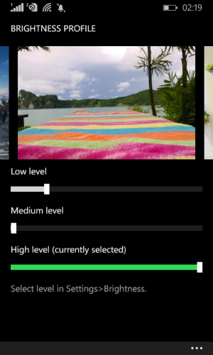

630 doesnt support really really low brightness setting .... regardless of which OS/Firmware. it will flicker.
so what you can do is got settings-->display-->brightness profile (adjust)
there you will see the levels for low medium and high respectively.
adjust the slider for low brightness such that the slider is just beyond the last 'l' of the level.
OR
put it in low and adjust the slider until the flickering stops.
try this ... this is how i have adjusted it.
