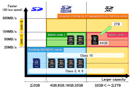

Here is a nice graphic comparing the speeds:
You'll notice that "UHS Speed Class 1" is faster than "Class 10", but for some reason the above Samsung microSD card is a UHS-I card, but only a Class 6, it works just fine in the phone for recording video (it was also rather less expensive compared to other cards). I recommend that people use UHS-I, or UHS-II (if you can find one) microSD cards in windows phones.
