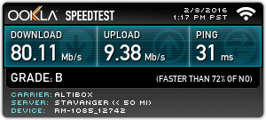

my upload never gets higher than around 10 Mbit on 4g and connected to my home wifi ( my landline is 80/80 see attached)46457618.png
