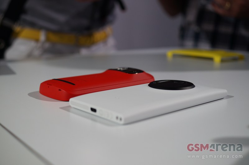

This partially explains why the hump is smaller:
1. Slightly smaller sensor
2.. Single capacitor for the xenon vs. 2 in the 808 (still more range thanks to newer tech)
3. Smaller xenon bulb
4. No loud speaker inside the camera hump
On the other hand.. 6 lenses vs 5 on the 808

On another note, the 808 seem a bit more ergonomic
