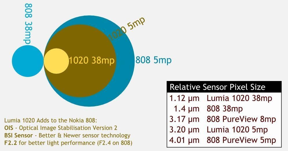

^ how did you get the 56% figure ?
It makes more sense to me in millimeters..
808 is @ 10,67 x 8,00mm
1020 is @ 9,00 X 7,00mm
The difference isn't that big, but still.. it results in smaller pixels
huh now I'm confused as some measures don't look right there, either it's not 1/1.2" vs 1/1.5" either it's not your measures :D even in your case it's 35% bigger
now if I look better if pixels on 808 are exactly 25% bigger(if it's the exact measure) then area should be roughly ~56% bigger no?

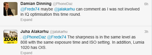

I found this on Juha Alakarhus' twitter, I guess this should shed some light on the issue haha :smile:
haha of course they will say only the best for 1020 since they are trying to sell the product (and they have stopped production of 808)

The case with the 1020 confirms this theory as it uses 1.12 micron pixels as opposed to 1.4 microns on the 808. So.. they kept the megapixel count, but at the same time made the sensor smaller.. its a workaround.
