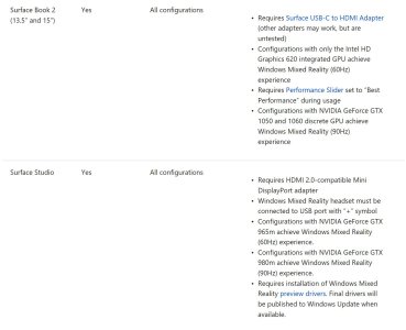

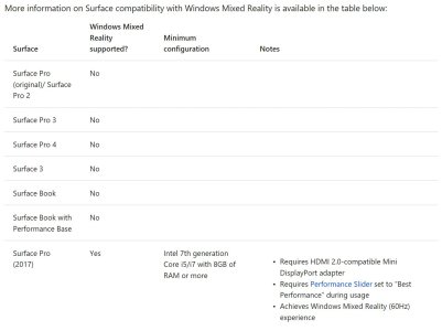

Did you follow the directions for the Windows Mixed Reality support?
https://docs.microsoft.com/en-us/windows/mixed-reality/enthusiast-guide/windows-mixed-reality-minimum-pc-hardware-compatibility-guidelines
Surface Book is incompatible.
Surface Studio is compatible but headset must be plugged into a particular USB port.
And yes, the adapter matters. I had problems getting my WMR headset to activate until I got the right adapter (I bought this one: https://www.amazon.com/gp/product/B...ag=hawk-future-20&ascsubtag=UUwpUvbUpU3728425). I have the Surface Pro 2017 with the mini DisplayPort.
