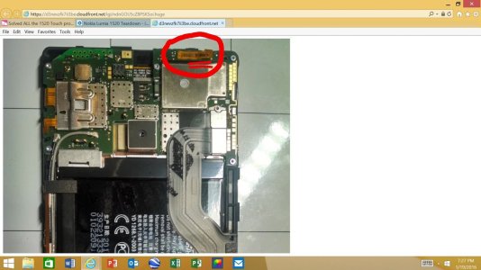

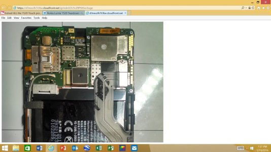

You lost me a little on this. Isn't there one cable from the LCD display into the motherboard, which is located underneath a shield to hold it securely in place?
Where are wires touching, and where exactly is this paper insert?
Here's a pic from ifixit teardown:

Tareq Mehyar
Oct 14, 2013
14
Goys this is exactly what I'm talking about!!!!
Thank you so much gordonfink for this picture I wasn't able to find a good one
And it has the exact same problem I had
Watch the upper right corner of the picture,notice that little orange cable,that's the problem,it's a little bent over itself ,and not held the the board,we only need and piece of non contact material (paper maybe) to hold it tight
DONT USE AND KIND OF GLUE OR TAPE IT WILL MELT DOWN WHEN HEATED AND WILL CAUSE SERIOUS PROBLEMS

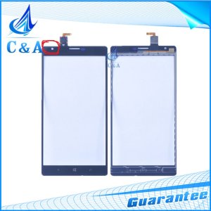

Are you sure guys?
Here's a photo of the digitizer,notice the cable up the screen it matches the one we saw here
Then again I CONFIRM that what I did solved ALL my touch problem and I haven't seen one in 4 months!Replacement-parts-for-Nokia-Lumia-1520-touch-screen-digitizer-n1520-LCD-glass-with-flex-cable-hi.jpg
The cable you circled is the front facing camera and is soldered onto the motherboard, its not even connect to the digitizer, but rather sits in a in a hole.

check this thread: http://forums.windowscentral.com/no...-1520-phantom-touch-solution.html#post3382378
There is a pic of the assembly minus the motherboard, which shows where the digitizer cable connects to the LCD assembly. The LCD assembly then connects to the motherboard under the shield on the left side of the pic I posted. the other cable under that shield is power/vol/camera flex.
it's possible, I suppose, that you fixed some connection underneath the motherboard, because the digitizer does connect to the south of the front camera, underneath.

I am very confused!
The pictures of the digitizer shows that its cable goes all the way up the phone,are you sure its not it?
It's clearly damaged and bent and since I fixed it the problem is gone!
Are you sure!!!!?????
Isn't the camera mounted in the motherboard? It's just the digitizer in the picture there's no camera here!
I'm positive this is the digitizer cable
gordonfink
Ambassador
Dec 5, 2014
1,402
That is absolutely the front facing camera. The digitizer cable you are looking at attaches to the LCD assembly. Look at the pic in the other thread I linked, and you'll see where it is. It lies just a little below the camera, under the motherboard. You can't see it with the motherboard in place.
I saw the pic ,and I'm very very confused,how come a front facing cable make my screen go wild! I'm 100% it was my problem but when you guys told me it's the camera cable....
What's going on? XD

It's definitely the front facing camera. Maybe just putting pressure there is enough to fix the symptoms?
I dunno, it definitely seems like the phantom touch issue is a poor connection somewhere, likely in the digitizer itself.
