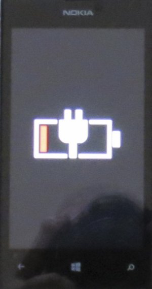

Since having GDR3 on my 520 there have been no problems until yesterday.
My battery suddenly drained very quickly and now will not charge or boot up, all I get is a screen like this:
But the strange part is that if I put this battery in my old phone, a Nokia 5800, this boots and charges fine.
If I put the Nokia 5800 battery in the Lumia 520 then that boots and charges!
I have done a hard reset of the 520 and its original battery still does not work even though it works fine in the 5800.
Any ideas what is causing this?

Have you inspected the connector pins? It sounds like one of the pins isn't making contact. Could be either the phone or battery side. Try taking a look at them and see if anything looks borked.
Hi badcat
Thanks for your help, that seems to have been the problem.
There was no obvious damage to the contacts on the battery. However I squeezed the contacts together more and now it works.
The connector pins on the 5800 must be slightly wider and so were making good contact with the battery but the 520's, being a bit thinner, weren't.
Thanks for the suggestion, because I could see no obvious damage I didn't give it much thought.

Awesome! I figured it was worth a try. Glad it worked for you.
