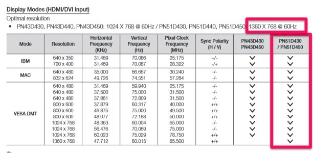

Looking in the instruction manual, the only resolution that is supported is 1360x768 60 Hz which is a nonstandard PC resolution. Could you possibly be using the Intel HD Graphics utility to make your adjustments previously? The standard Windows one probably can't do that odd resolution but the Intel utility might be able to.
I am aware it's 720p, and yes the windows display settings can do 1360x768. I still get the same problem. Works on mirror or extended, but will not accept as monitor 2 only.
I will try using the intel HD graphics utility, I can't remember if I had it on my last SP2 or not.
