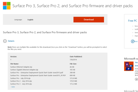

I haven't received the updates yet either, but I did find this at the MS forums.
The following updates will be listed as ?System Firmware Update ? 7/8/2014? within the Windows Update History.
? Surface Pro Embedded Controller Firmware (v.38.2.50.0) reducing power consumption, and enhancing system stability.
? Surface Pro System Aggregator Firmware (v. 3.8.250.0) enhancing battery life, and increasing efficiency and reliability in low power states.
? Surface Type Cover Firmware Update (v. 2.0.1021.0) improving trackpad reliability and system stability.
? Surface Accessory Device (v. 2.0.1012.0) helping the on screen keyboard (OSK) appear and disappear at the correct times.
? Wireless Network Controller and Bluetooth (v. 15.68.3042.79) enhancing system stability, reducing power consumption in low power states, and improving some WiFi connection scenarios. We will also issue an update on Wednesday, July 16, to further improve WiFi connection and throughput scenarios.
Note When Surface updates are provided via the Windows Update service, they are delivered in stages to Surface customers. As a result, not every Surface will receive the update at the same time, but the update will be delivered to all devices. If you have not received the update then please manually check Windows Update later.
