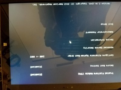

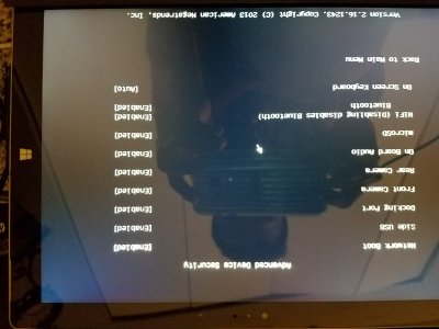

so i went back to linux and delete all the partition without formatting them. and here is my current UEFI settings. it still won't boot from windows usb drive
Hmmm....
We know that the SP3 boots fine with a Linux Live USB.
We know that the Windows Recovery USB boots fine on another system.
How long have you let the SP3 sit, trying to boot the Recovery USB?
Is there a MS store near by? You might schedule some tech time with them and see if they can't get it working (it's usually free for this type of thing. It only costs if they find something physically wrong)

i left it overnight and it still stuck in that circular loop. The closest microsoft stop to me is 3 hours drive :(. By the way, i saw the network boot as an option. DO you know what that is? I want to give that a try
Network boot requires a server to get things working. I never got around to setting one up in my career of a sys admin, I only read about it.
Personally, I would take a day and go to the MS store to see what they can do. I think we've explored most of the options that I can think of.
