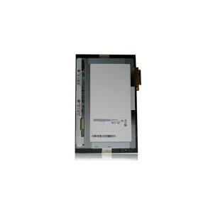

Got it apart. mSATA and screwed down. Bad news though I did not heat the glue sealing the case well enough so when I took it apart I ripped the touch sensor cable. Heat that glue good but after that it is simple. Plugging in a 240GB MyDigitalSSD mSATA at $179.99 is 100% possible. Pics and more to come.

Ran across this:
Don't know anything about them but unless someone figures out how to fix the cables it may work.

but doesn't your touch screen not work now since u ripped the cable?
touch capabilities > larger ssd
Everything works fine no idea what that cable was for. It was one of the cables attached to the display for sure.
If you don't get lazy and you heat all the glue well you will be fine.
