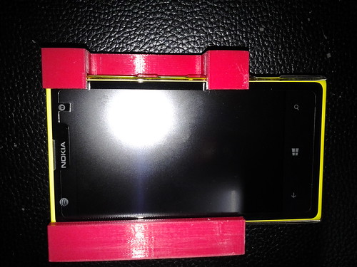

I have made a prototype of the filter holder. I still need to find the right screws to hold the clamps and I forgot to make a tripod screw hole underneath. :eck:
Untitled by Robobit, on Flickr
