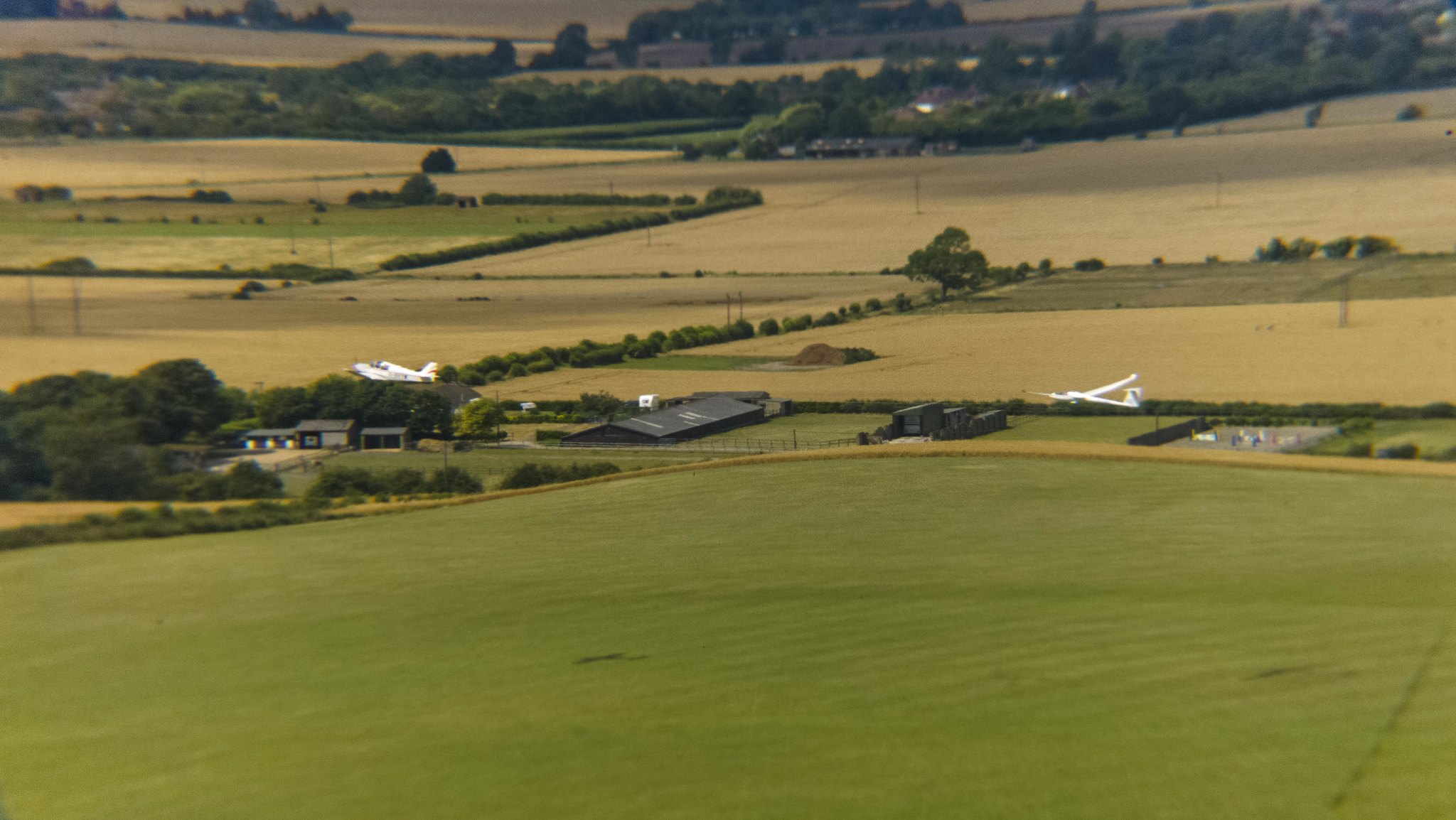

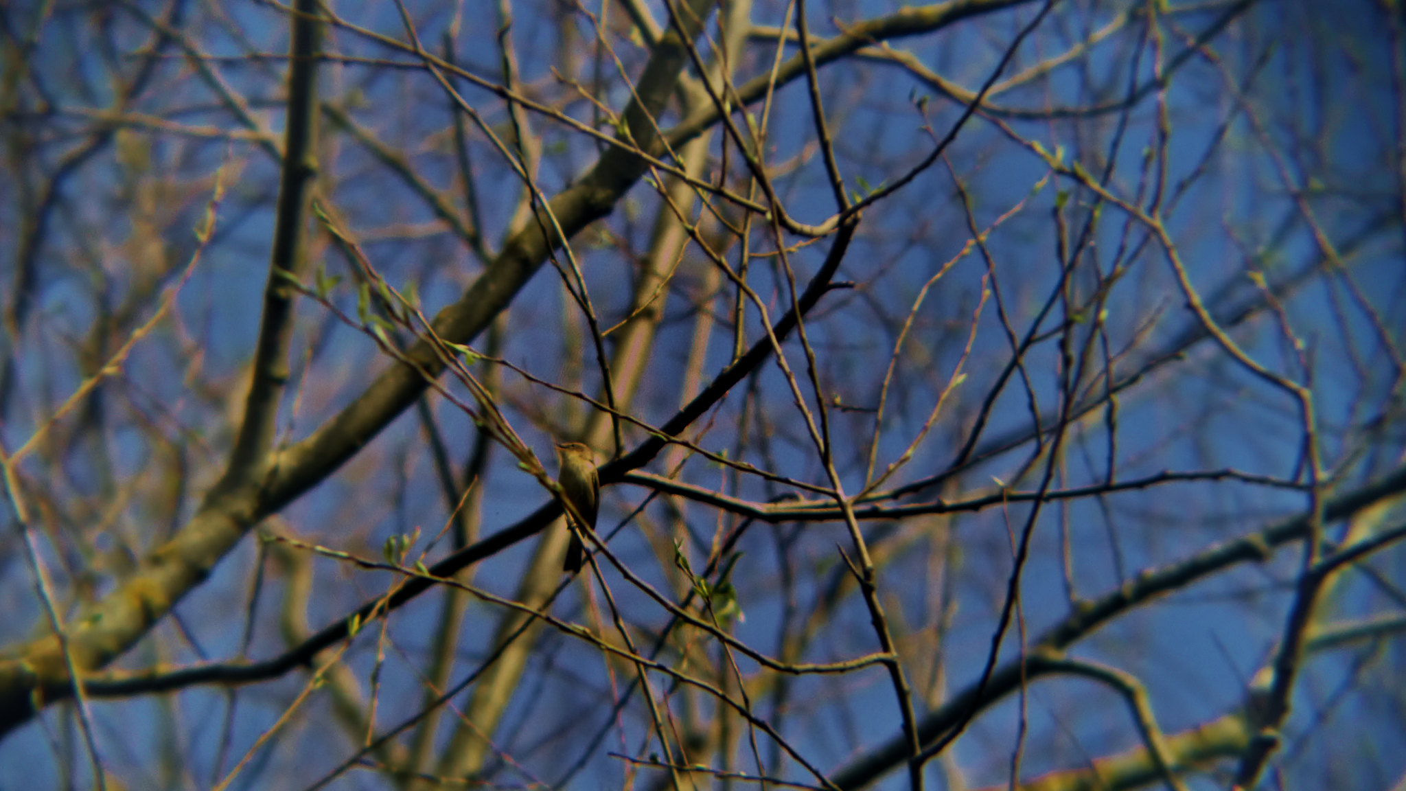

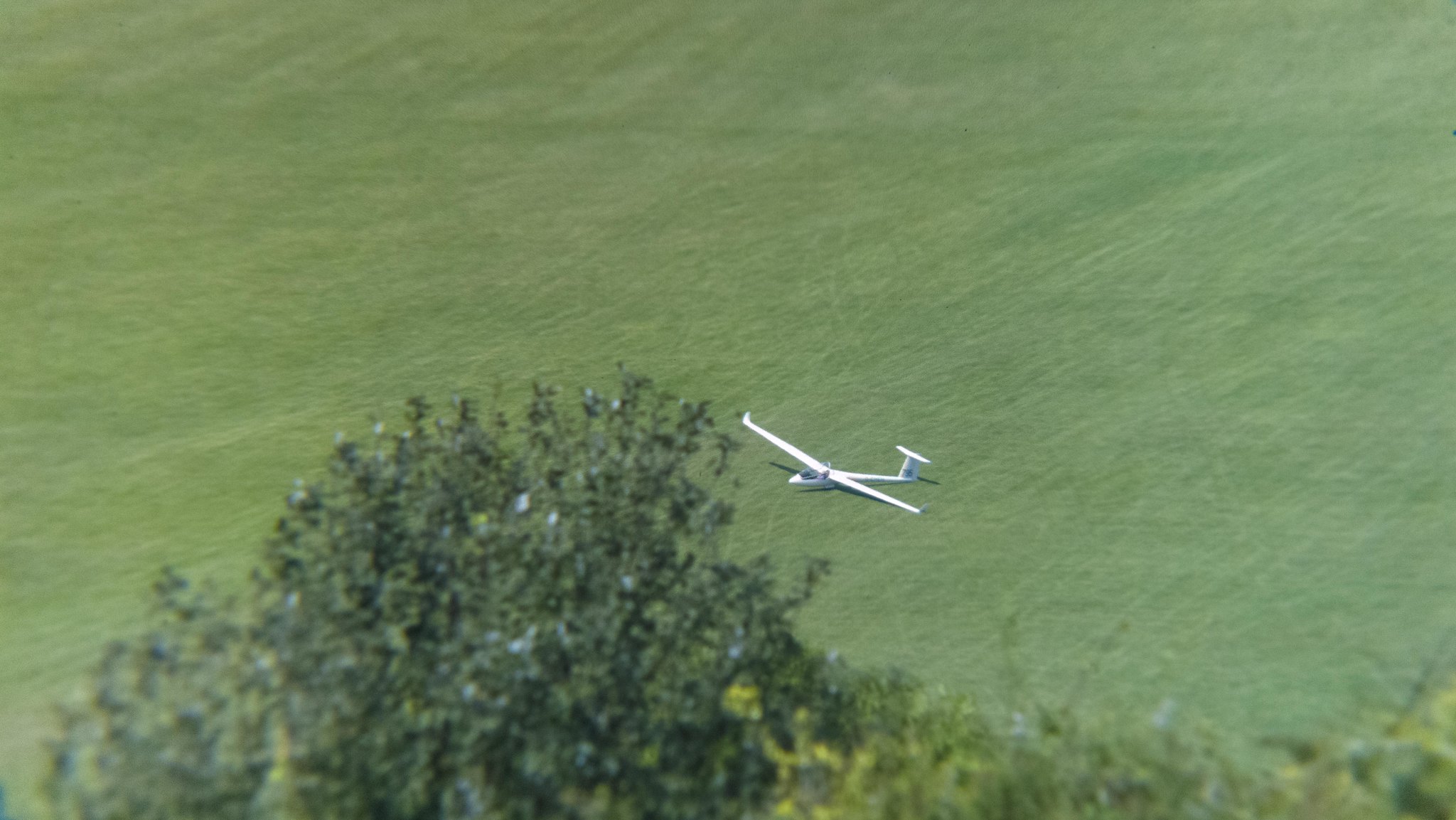

The only telephoto lens I have used it with is an Optomax 200mm M42 lens, which I have to use with a DOF adapter. The downside being it is a Manual Focus lens and you cannot use the AF on the 1020, so fast moving subjects are challenging unless you have lots of light and are good with the focus.
Taken from about 500 metres away;
Dunstable Downs-2 by Chris Leach, on Flickr
Dunstable Downs-1 by Chris Leach, on Flickr
From about 150 metres away;
BeastGrip Mini-13 by Chris Leach, on Flickr
WP_20140330_13_34_21_Raw__highres by Chris Leach, on Flickr
The problem with that lens is as the focal distance is so far away even the smallest twitch can be too much for the 1020's OIS to correct. A 100mm lens may be the best option.

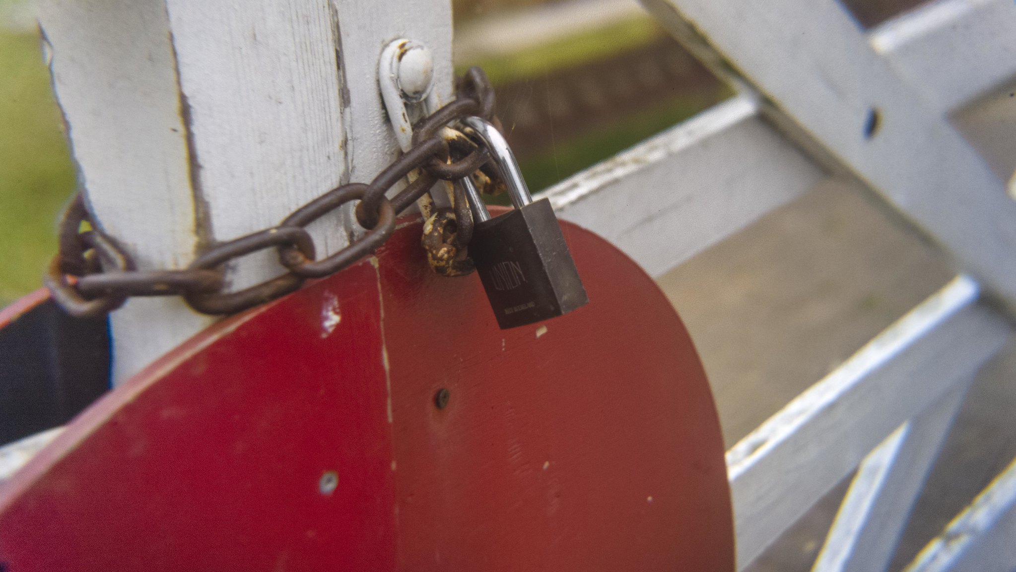

Here are examples using a Carl Zeiss Jena Tessar 50mm M42 Lens;
About 5 metres away
DOF V4-2 by Chris Leach, on Flickr
DOF V4-3 by Chris Leach, on Flickr

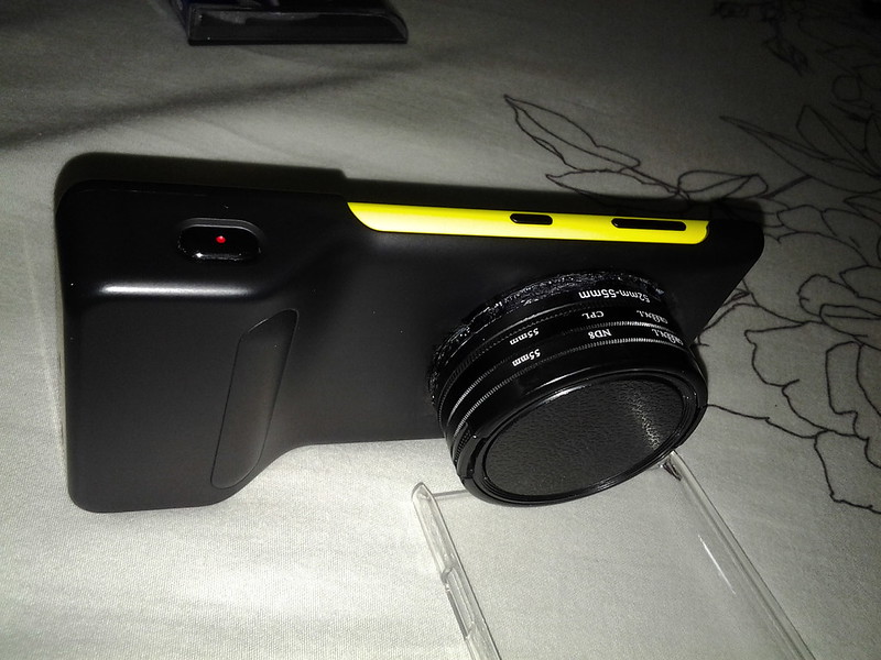

I glued a 62 mm adapter ring and aligned it to be centered with the camera lens. so no distortion for me ;)
Excuse me, can you show a pic of the phone with the ring?

I know it's not very "pretty", but it does the job ;)
I did not mod anything at all. I put the Sugru on the 62mm ring and glued it on the camera grip (very important: off center, so that the middle of the ring is exactly above the lens).
Yeah, need to center the lens with phone lens. I think the best effect is using black case/grip. My camera grip is black and nilkin case is white, I brought sugru in black colour too. (to reduce internal reflection)
