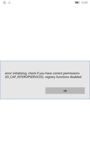

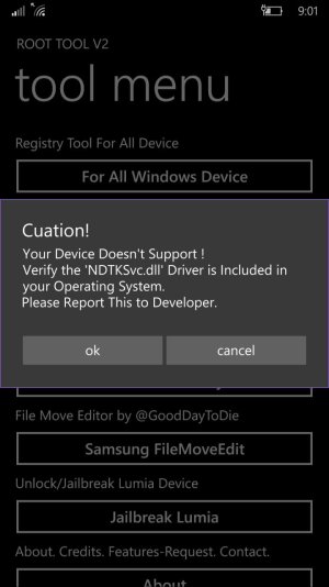

I've been struggling with this on both the vcreg1.5 app and the RootTool.xap app. I thought I was going crazy and missing something. Everything works pretty well for me on build 10586.164. I just wanted to add a hosts file so I can use it to adblock. I don't care about much more customization than that
