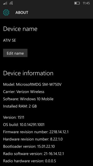

so I've got 14291.1001 running on my second SE; i'll compare the 2 different buildsView attachment 124064 over the next few days and let you know how the do...

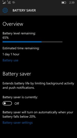

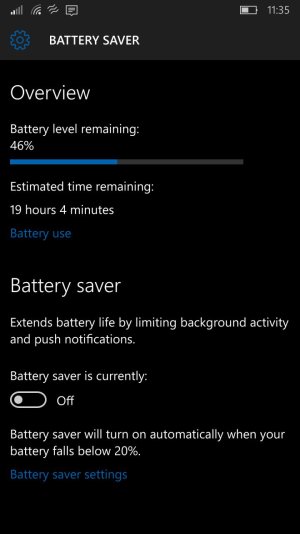

Hey guys, I finally tested out my battery levels today while using Data. Here's the breakdown:
1. 6:40 AM Unplugged phone from charger
2. 6:50 AM Opened Pandora and streamed music over Data for about an hour and a half
3. 8:30 AM Phone idle
4. 11:10 AM Played music with Groove Music for about an hour and a half
5. Did some email checking and some other insignificant things
Here's my battery level at 2:39 PM:
Phone was used a bit after this
Here's my battery level at 11:35 PM
As you can see, I certainly don't have battery issues, even when using data streaming music.

Lucky you. I have issues too but not horrible. My battery lasts for half day with moderate usage. Yours is far from reachable for my mobile. One more thing, my cell gets hot down the camera while in continuos use or while using data services
