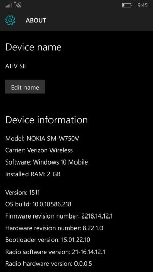

got an update today to 10586.218
i'll see how this works...
