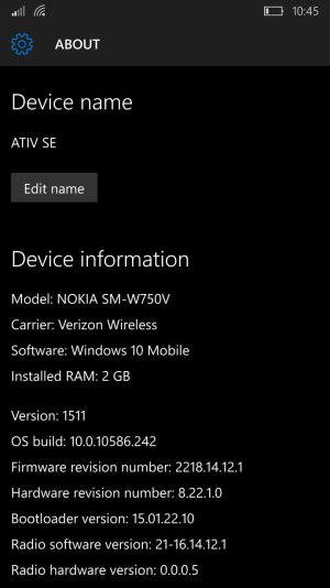

I tried but my phone will not update past 10586.218 no matter what I try.

Okay, I am finally getting the .242 update. I did some reading and found out you need to be on the Release Preview not the Slow or Fast Rings. I am going to try the Fast Ring again after this update completes.
