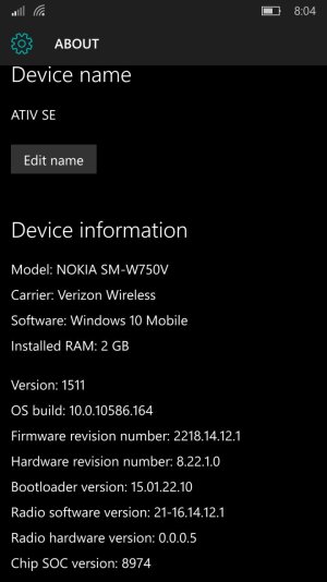

I tried Redstone; drained my battery like crazy; phone ran super hot. Went back to setting my phone as a 'NOKIA' 'RM-927'; running .164 and it's cool and smooth, with normal battery life. Only thing goofy is the glance screen doesn't work.
