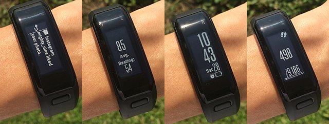

Please please please Mr. Microsoft Santa - for the next firmware upgrade I whish an option for portrait/vertical watch mode. Like the Vivosmart HR (see picture)
