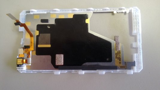

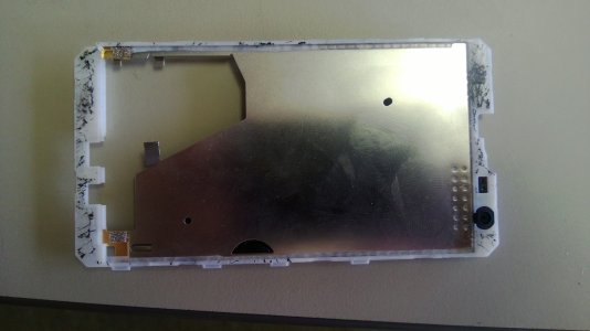

I own a Lumia 920 and unfortunately, have had the pleasure of replacing a digitizer for someone with a 920. Today I replaced my first Lumia 1020 LCD+digitizer. The screen was ordered from etradesupply.com and cost around $188. It only took a few days to arrive and was packed nicely between layers of a foam inside a plastic container. Taking the screen assembly off wasn't very difficult at all. There's a PDF floating around from Nokia Care that shows the teardown of a Lumia 1020. I turned the phone off, popped out the SIM tray, unscrewed a #4 torx screw and opened the screen starting with the top left corner. I disconnected the cable for the screen, the cable for the front facing camera, and the battery cable per the instructions. The only thing the PDF didn't mention was how to remove the digitizer and LCD from the plastic assembly. It wasn't held with normal adhesive, it was actually glued. I found that out after trying to heat the glass for a while. I ended up breaking the glass around the inside edge of the plastic assembly so I could remove the LCD then scraped the rest of the glass off of the assembly with a small screw driver. It took about an hour and a half to get all of the glass off. Here are a few pics of the cracked screen and the plastic assembly. I had double sided black adhesive that I usually use when replacing screens but it was a little too thick. The only other adhesive I had was double sided carpet adhesive and it worked like a charm.

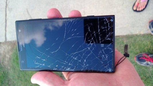

Dropped my 1020 last night. LCD works fine, but the glass is broken. Looking for a replacement as well!
