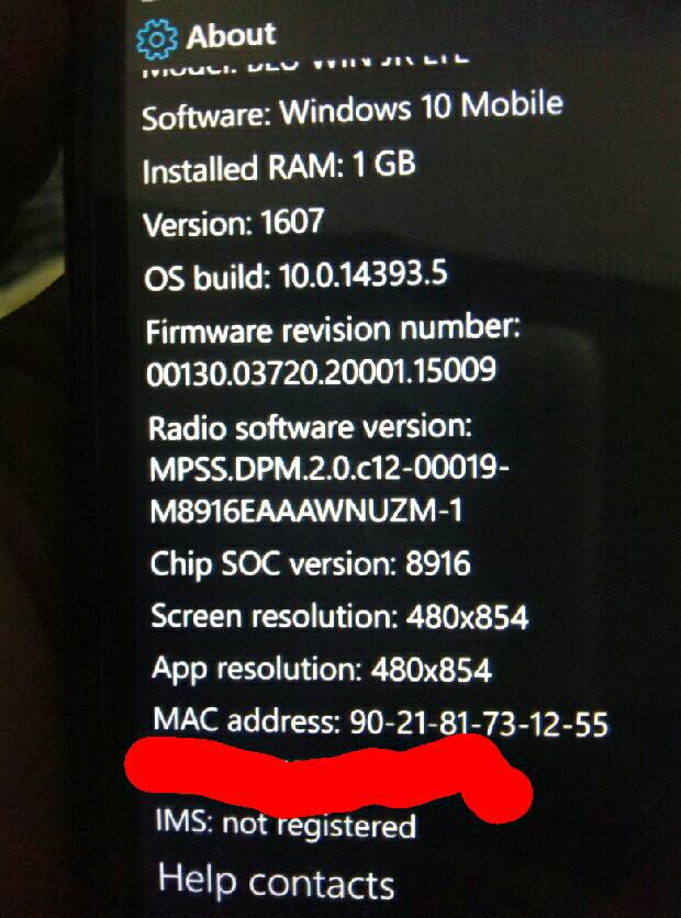

<image containing IMEI removed by moderator. You can repost the image if you edit out the IMEI first>

We are now stuck as we will have to remain on WP8.1 after using WDRT as the latest build downloaded will be 14393 instead of 10586. Unless Microsoft fixes this simple issue, we are stuck with a phone that has to be force downgraded to WP8.1
The problem is explained at the below link. They basically messed up the screen resolution and put in a value other than 480X854 which is the actual resolution of this phone.
