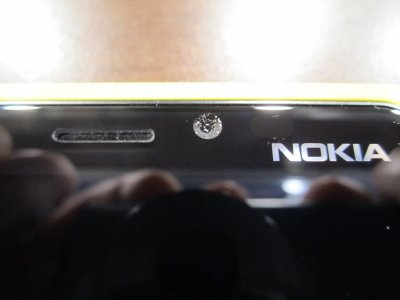

Proximity sensor is located right above the N of NOKIA logo. You can see it by watching from the right angle. Here's a photo of mine, I sent it back because of the dust:
Thanks. I looked at mine and can see absolutely no evidence of any dust or foreign matter whatsoever.
So I guess the next question is this: do I now contact AT&T or Nokia to get the problem solved?
I've had the same problem with two L920's now and you can't see the dust on the proximity sensor, but clearly you can see it on the front camera. But I think that you still can have dust on the proximity sensor even if you don't have it on the front camera yet. Just try to blow in the gap between the glass and phone body just above the NOKIA logo and you might get a temporary fix.
I will try that, even though I'd much rather have a permanent fix instead of a temporary one....... Maybe I'll just give AT&T a call, and see what I can do about it (especially with the battery problems that exist as well).
