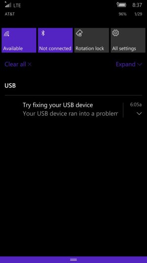

Hello all. I have started receiving pop up messaged on my Lumia 950 device that states" Try fixing your USB device. And "Your USB device ran into a problem. Also the phone will not charge via the USB port unless I shut down the device and plug the USB in while the phone is powered off. It will then turn on as normal when I plug it in. I haven't done much troubleshooting on it yet and couldn?t find much when searching for it. If I click on the error it takes me to an out dated windows XP troubleshooting page.
I think I am going to try and restore the phone tonight after work to see if that may help. I've had to reset my phone so many times its becoming routine.
Has anyone else experienced this?
I'll ask the obvious... What did you plug it into? Using the usb-c cable that came with it?
Actually nothing. I charge with my Qi charger and only sometimes used the rapid charger that came with it but I haven't used that in over week before this started. And of course I checked for debris in the port and it hasn't rained or anything where moisture could get in there.
What puzzles me is that when the phone of off it recognizes the charged being plugged in right away and powers on as it should. I am wondering if this is a software issue of some sort. I wont be able to factory restore it again until after I get home from work.

I've been getting this error multiple times over the day. With NO "USB device" plugged in. :eck:
I'm not sure if it is caused by the "Anniversary" update, or the firmware update.
I'd guess firmware, but...
Can it be rolled back? (I'm not an Insider or anything like that.)

Check the USB port for dust and other crap. Something might be stuck there triggering the error message.
Well, blowing the dust out of the port seems to have cut down on the errors, but they're still popping up from time to time. Maybe get some contact cleaner or whatever.
If that doesn't do it, I'll go the WDRT route, I guess. Much as I hate to do that.
Try to carefully poke around a little with a wooden toothpick or something. Carefully though!
Finally got everything to download and install.
Phone worked for 10 hours, an then the "Try fixing your USB device" error came back.
This NEVER happened before the "Anniversary" update.
Microsoft say to go to AT&T. Yeah, right. I bought the phone directly from Microsoft...AT&T won't be able (or willing, anyway) to do anything other than tell me to do everything I already did.
