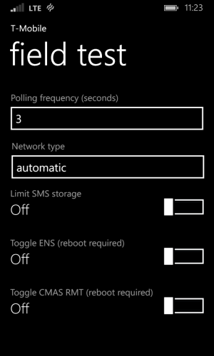

This is how it looks under settings in field test mode on my Rogers 920, try to check if it's the same for you.
Any idea what the "Toggle ENS" does? On my 1020, like yours it is turned off. On my 920 it was turned on. I switched it off, cycled the phone, and still no love.
