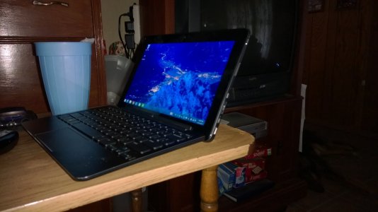

I think it may be that my keyboard is a older style that Dell doesn't sell anymore. Well I hope they get it working for you... This is as far as mine bends:

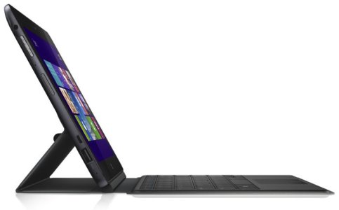

That keyboard you have there is the mobile keyboard with battery. I have one of those as well. The slim keyboard looks like this.
So it's really a keyboard cover that folds around the tablet.
