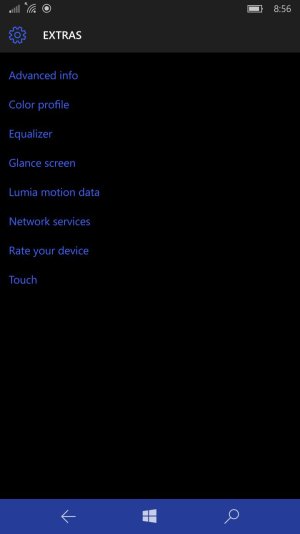

Is there any one facing same problem? can't turn off navigation pane vibration feature, very annoying.

go in Settings and type in search line "to". Do it gave some result?
nothing, I mean no "touch" menu

well i fix it by recovering 8.1 and then perform a clean update to WM10 xxxxxxx.122 and everything working.
I think it was some glitch because of my settings and all the 3rd party apps installed when i updated to WM10.

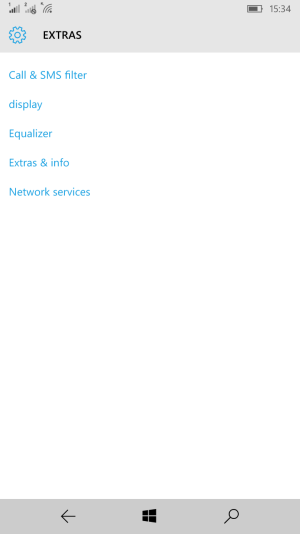

I think it is not necessary to upgrade from 8.1 to 10 in order to get the "touch". mine just factory reset and the following picture is what the "extras" menu shows:
you can try hard reset again such that your system is a clean 10 rather than a "10 upgraded from 8.1".
or you can check using sysapp pusher to find the app and see if its installed/needs update.
last option is hard reset.

I have had this issue alot, it's an easy fix if you ever run into this scenario again, you go to storage and apps, find the "not compatible" or often on mine it's "missing" app in question and uninstall the app and then use Sysapp pusher to reinstall and boom all is gravy no need to recover or hard reset! This happens with gadgets and touch alot on my lumia1020.
