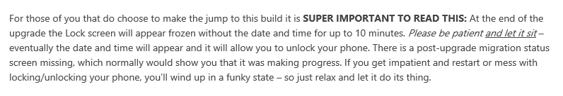

Did you folks heed the warning posted in the blog? I posted it above.
