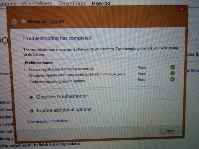

I tried that. It did not work. I'll even attach a pic of when it said it fixed issues. I thought that was gonna fix everything but it still gave me the same error. Very annoyed and frustrated, I sent it back for a replacement. I hope it was just that specific DV8P with the update issues.

Just hit this problem while installing my son's new Dell Venue 8 Pro. I ran the update troubleshooter as suggested on this thread. Then I went into the list of updates and unchecked all except KB2919355. Once that one has installed on its own, reboot, and do a full update.
It seems to have worked for me. Hope this helps someone else.
