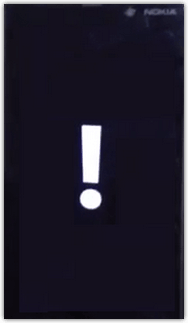

I suddenly lost the control of the ringer (volume ) of my phone and decided to re-start it, but i received a warning sign and it has been so for the past 15 hours
Re: can't re-start my phone
Does it look like this?
Plug in so you have power, wait maybe 30-60 minutes just to be sure there is enough charge (because you've already been on standby with screen lit 15 hr +)

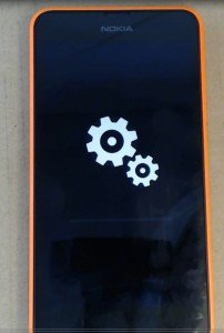

Tap Volume Up, Volume Down, Power, Volume Down in order and the phone should vibrate and you will see Gears:
The phone is now Flashing the last OS version held in memory. restore your backup during the setup process.
If you need further help, join the site so you can reply in this thread and leave more details as to what the "warning" looks like...
