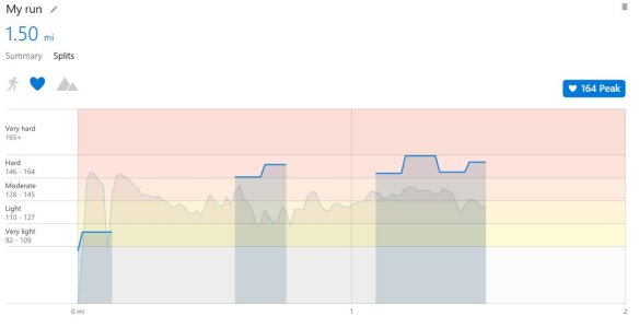

Hi All,
I just started to use the Run tile on my Microsoft Band 2 and have found the heart rate measurement a little spotty.
First run was short and no HR data showed up.
Second run was a mile and a half and whilst all the HR metrics populated (Avg. Peak + Low, Ending, 1min + 2min), the HR graph has large gaps in it. Seems that for about 50% of my run, no HR data was available?
Is this normal? I wear the Band with the display facing inwards and use it with a 950XL
In all other respects, it's a solid wearable.
Thanks.
It's not getting a lock on your heart rate for some reason. (Heart symbol is hallow.) If it doesn't have a "lock" it will still display a number, but it won't record.
Different people have different experiences. Mines is that movement tends to create more problems than sitting still. You may want to try a different orientation, a different arm, a different spot on your wrist, tighter or looser. (It needs to be tight enough that it doesn't move, but loose enough that you're not restricting blood flow under the sensor.) Since every body's body is different, I'm not sure as there's a universal "best way".
Certainly not normal. Do you know if the sensor is getting a solid lock when you're not doing any exercise? Tap on the 'me' tile and swipe over to the heart rate section (last one to the right). It should start out as acquiring, but achieve a lock within 5 to 10 seconds. If its locking ok that way, try starting a run, but just wait a bit before you start running, to see if its tracking hr. What you want to see is for the little heart icon to be filled in, not just an outline. Might take some experimenting, but if you're wearing it fairly snug and it doesn't stay reasonably locked, it may have a defect. Short drop-outs are not uncommon, but what you're seeing is definitely not the norm.
Were you running with your phone at the time with the bluetooth link on?

Lock is normally solid when I'm not doing exercise. It shows the solid flashing heart and says "Locked"
Another interesting thing is that when I use it to track other activities (e.g. a yoga class) via the exercise tile, it seems to track HR fine???

To confirm, the Bluetooth link was on (I did not turn it off) but I was not carrying my phone on the run.

I don't really have a point of comparison but I feel I wear the band on the tighter side. It can move around a little bit if I shake my wrist but if I look at how it sits on my wrist, both the optical sensor (back of the display) and the "galvanic skin response" sensor are typically in light contact with my skin.
